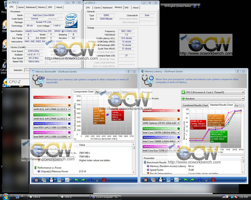

With the same board, we overclock a QX6550 processor on it to
2.705GHz (451MHz x 6). At this speed and with a memory multiplier of 4x,
DDR3-1800 MHz is achieved. The memory runs at 902MHz at CAS 10, 12, 12,, 31, 2T.
The memory bandwidth is 7565/7550. Memory latency is 84ns and
speed factor is 71.6.
Some interesting observations can be drawn from the
test. At DDR3-1600 (400MHz x 4), Memory bandwidth scored 7773/7777.
Memory latency is 78ns with a speed factor of 79.4. At DDR3-1600, the
module runs at CAS 10,11,11,31,2T.
We shall let you decide which is a better setting.
