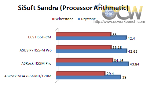

SiSoft Sandra 2009
In this test, we compare the board against 2 other H55 boards and and AMD 785G board running a AMD Phenom II X3 710 clocked at 3.33GHz. We wanted to see if the Intel's new Clarkdale performance pit against the AMD processor running on a 785G board. The board used is a ASRock M3A785GMH/128M we reviewed last year on OCWorkbench.
First, we check out the Processor Arithmetic scores of SiSoft Sandra 2009.
From the chart, we can clearly see that the difference in performance of the 3 boards. The ECS H55H-CM is definitely at a slight disadvantage as there are no options available in the BIOS to fine tune the ram timings. The ASUS P7H55-M Pro is slightly faster but it falls behind the ASRock H55M Pro largely due to ASRock's higher BCLK at 138MHz. When compared to the ASRock M3A785GMH/128M, the Intel Core i5-661 based systems are clearly leading the way.

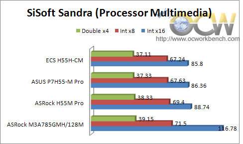

In the processor multimedia department, the same situation seems to affect the 3 Clarkdale boards. The 3 boards perform similarly but the differences are largely due to clock speed and ram timings. Surprisingly, the Phenom II X3 710 running on the ASRock M3A785GMH/128M is on par and even perform way better the Int x16 test.
