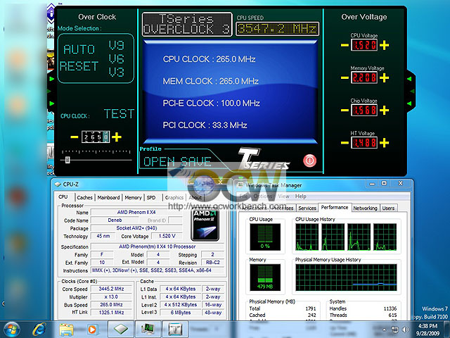

In terms of overclocking, the BIOS has lots of options for you to play with. You can tune the board using the 3 options of V tech engine to select the tested overclocks and boot up instantly Alternatively, you can also overclock the board using the TSeries Overclocking tool bundled in the package software. In our case, we were able to oveclock the Phenom II X3 710 to 3.547GHz with the voltage levels shown in the screen shot below. CPU CLK was at 265MHz with multiplier of 13x. You can also save the profile for future reference or use for various oc settings. As for GPU CLK, our best is at 980MHz with our 3 core processor. Enabling the hidden 4th core is possible but you will have to lower the HT to 1.6GHz from it's default 2GHz.
