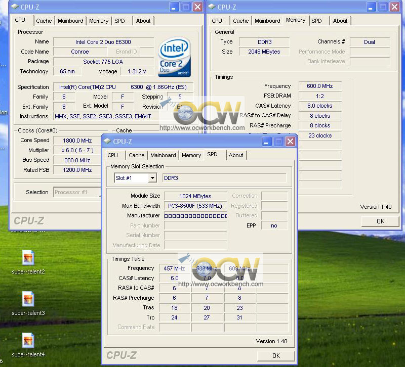

Firstly, we run the board with a E6300 at 333MHz FSB. That overclocks the CPU and the RAM. The RAM module, using a ASync 4x multiplier now runs at the speed of DDR3-1333. We can see that the RAM actually auto sets itself to run at CAS 8 at a freq of 600 (1200MHz) as shown in CPU-Z.
We tried to increase it to 333 (1333MHz) but the system couldn't POST. This seems to be the case since SPD already mentinoed that the supported Max freq is 609MHz. Anything beyond that might be unstable. That is why no matter how relax we set the CAS to 9 or 10, the system just couldn't POST.
The tests were all done with VDIMM at 1.7v with CPU vcore bumped up by +0.1v from within the BIOS.
