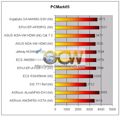

PCmark05 gives us an indication on how the system performs with effects from the bus system.
The boards are run using the integrated graphics core. As we can see from the chart below, the AMD 690G has an edge over its older RS485 chipset by approximately 7%. This could be due to the use of SB600 south bridge.
Catalyst 7.4 is used and we found that the board scored 3673 (cat 7.4) , which is better than the other amd 690g boards we tested. A check on the score with Catalyst 7.3, the result is similar to that of the  ASUS M2A-VM HDMI board.
