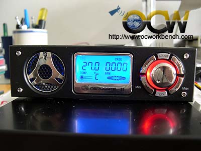

Just power on, probe is reading room temperature.

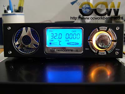

As you can see from the screenshots, the room temperature is 27C. When we placed the probe in, it registers 32C after a while and it is quite constant. There are not disk activity at this moment.

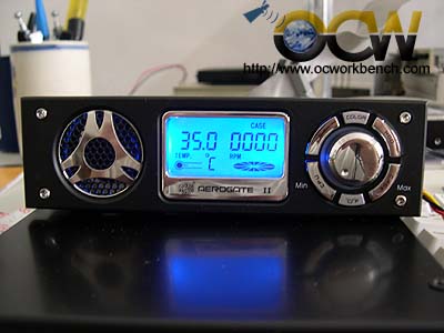

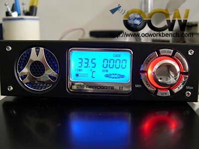

Later we ran HDtach followed by SiSoft Benchmark one after another. The temperature rises from 33.5C to 35C. We did a check on the same HDD (no enclosure), we are getting around an average of 34C.
