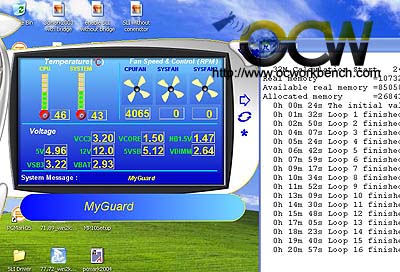

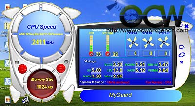

In the simple test, we used Super PI 32M to test heat up the CPU. In the aircooled environment, we used the normal Gigabyte 3DRocket Cooler. Board used is a Jetway NF4 SLI running Corsair DDR400 at CAS 2, 5-2-2 1T cmd. CPU temp is set to default (1.5v) and vdimm is 2.8v.
As we can see from the diagram below, the CPU temp was recorded at 33 degrees when idle and 46 degrees after the burning in. The fan speed was not recorded here but it is at 2500rpm.

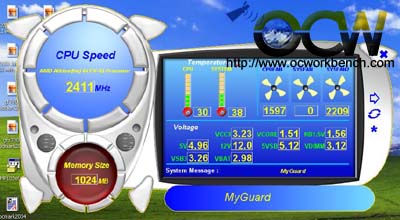

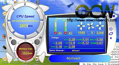

As for Liquid cooled, the idle temp starts from 30 degrees and rises to 45 degrees over time. The CPU fan speed is 1597rpm and the radiator fan speed is at 2209rpm.
It is not difficult to see that liquid cooling does help to keep the heat levels down to below 50 degrees. We went ahead and test for push the CPU further.
