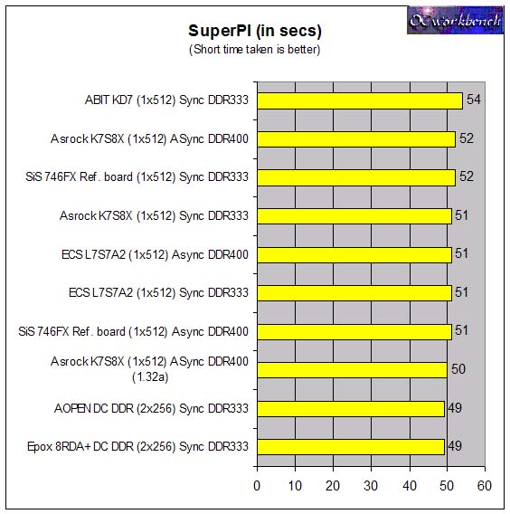

FPU test (fsb:166, AXP2700+)
SuperPI
SuperPI is a good test of system stability and also the arithmetic power of the system. The shorter the time taken, the better the performance.
All boards running in SYNC DDR333 (166/166) otherwise specified. The FSB of the various boards are :
AOpen AK79G Max : 167.04Mhz
ASROCK K7S8X : 166.64Mhz
ECS L7S7A2 : 166.65Mhz
SiS 746FX Ref board : 168.2Mhz
EPoX 8RDA+ : 167.05Mhz
ABIT KD7 : 166.88Mhz
nForce2 boards still leads with 1 ~ 4 sec faster than other chipsets.
