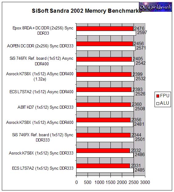

In SiSoft Memory benchmarks, the Dual Channel DDR Epox 8RDA+ leads the pack. AOpen follows right behind the EPoX 8RDA+. ASrock K7S8X scores as close as the ECS L7S7A2. In Async DDR400 mode, the result seems a bit low. Looks like the nForce2 boards still perform in a Dual Channel DDR mode.

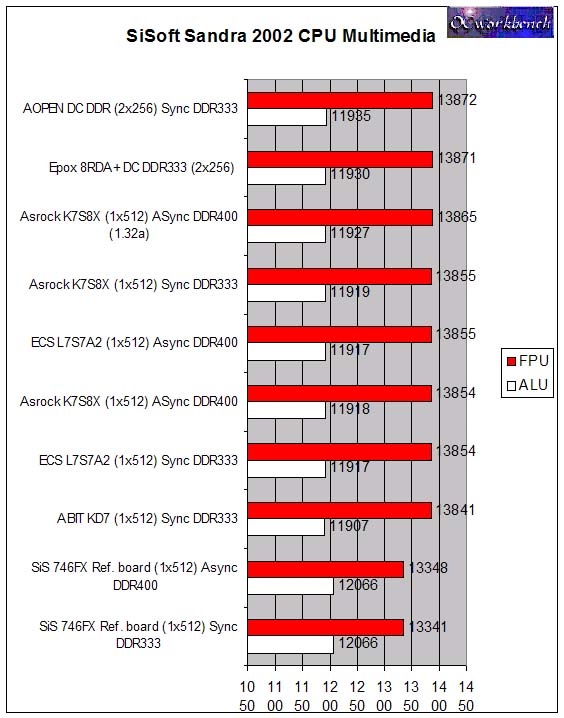

In the CPU Multimedia tests, the AOPEN scores much better than the EPoX 8RDA+ leading by just a few points. Again we see that the nForce2 SPP or IGP performs similarly.

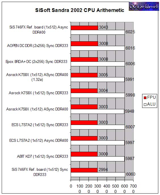

In CPU Arithmetic, we see that both nForce2 boards scores almost the same. Something worth noticing is that a 1Mhz difference from 166.6 to 167.4 might affect the scoreline. (See above at what fsb are the cpus actually running).
