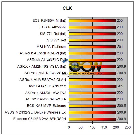

In this test, we measured the CLK used by the boards. Both boards are set to run in SPD mode of the modules which is rated CAS 5, 5-5-15, 2T. The MSI K9A Platinum runs at 201MHz which 1MHz higher than default. The ECS KA3 MVP Extreme based on the same chipsets runs at 1/2 a mhz slower. Both the ECS RS485-M-M and SIS 771 reference board runs on 200.00MHz on the dot.

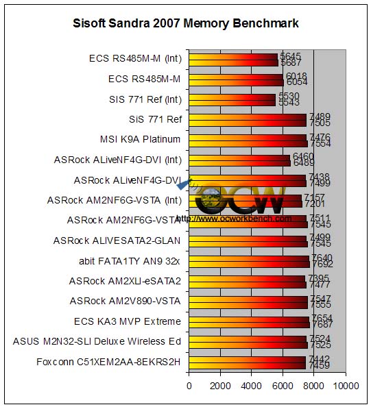

With that in mind, we take a look at the memory benchmark scores using Sandra 2007. The SiS 771 is comparable to th rest of the AM2 boards. Notice that the levels dropped to 5530/5543 when 128M of shared memory is used.
