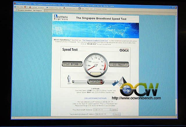

Next is Speed test and it is able to get 70Mbps downlink and 20Mbps uplink. Another try give us 87Mbps down and 18Mbps up. This is definitely way better than what you could get from a HSPA+ connection. We check out the latency too and it is around 20-30ms.
