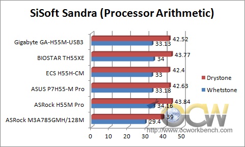

First, we check out the Processor Arithmetic scores of SiSoft Sandra 2009.
From the chart, we can clearly see that the difference in performance of the 5 boards. The Gigabyte GA-H55M-USB3 being clocked at 133.3Mhz on the dot stands to lose out a bit to the other boards which tuned up their BIOS for performance advantage. In this test, it scored 33.13 for Whetstone and 42.52 for Drystone.
When compared to the ASRock M3A785GMH/128M, the Intel Core i5-661 based systems are clearly leading the way.

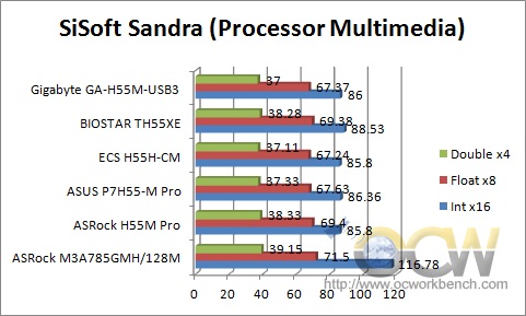

In the processor multimedia department, the same situation seems to affect the 4 Clarkdale boards. The 5 boards perform similarly but the differences are largely due to clock speed and ram timings. We again see that the scores are very close to the ECS H55H-CM in Double x4 and Float x8 tests.
Surprisingly, the Phenom II X3 710 running on the ASRock M3A785GMH/128M is on par and even perform way better the Int x16 test.
