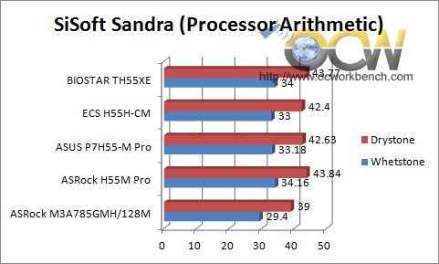

First, we check out the Processor Arithmetic scores of SiSoft Sandra 2009.
From the chart, we can clearly see that the difference in performance of the 3 boards. The ECS H55H-CM is definitely at a slight disadvantage as there are no options available in the BIOS to fine tune the ram timings. The ASUS P7H55-M Pro is slightly faster but it falls behind the ASRock H55M Pro largely due to ASRock's higher BCLK at 138MHz. The Biostar almost trump the quad but it is still slightly behind the ASRock H55M Pro as it is very close in terms of BCLK. It is important to note that 1MHz difference in BCLK can result in a jump of a few 25 hertz as the CPU multiplier is 25x.
When compared to the ASRock M3A785GMH/128M, the Intel Core i5-661 based systems are clearly leading the way.

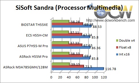

In the processor multimedia department, the same situation seems to affect the 4 Clarkdale boards. The 4 boards perform similarly but the differences are largely due to clock speed and ram timings. We again see that the scores are very close to the ASRock H55M Pro in Double x4 and Float x8 tests.
Surprisingly, the Phenom II X3 710 running on the ASRock M3A785GMH/128M is on par and even perform way better the Int x16 test.
