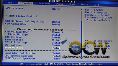

Likewise iGPU can be adjusted from 0.5v to 1.75v |

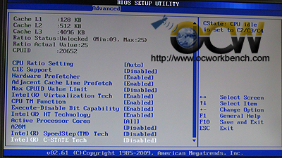

CPU multiplier can be adjusted. For Core i5-661, the max
is 25x |
Other settings available. |

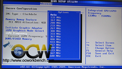

So far, only ASUS board has the option to tune the iGPU
frequency. Default for Core i5-661 is 900MHz. The range available for tuning
is up to 1.5GHz. |

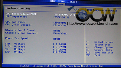

The FAN speed and temperature can be monitored here. |

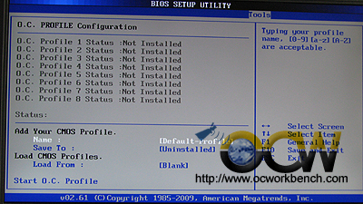

There are 8 slots of OC Profile which you can save for future
reference and use |

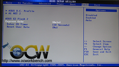

Last but not least, ASUS board comes with Express Gate,
allowing you to surf, IM without entering the OS. |
