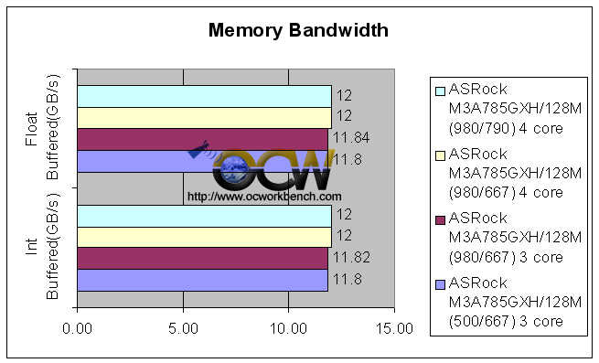

The first is the default timing with GPU running at 500MHz and side port memory at 667 MHz (DDR3-1333). The second test is with GPU overclocked to 980MHz with voltage bumped slightly to the mGPU voltage. 900MHz is only achievable on the mATX version M3A785GMH/128M.The third test is with the the 4th core enabled and in the fourth test, we increase the sideport memory to  790MHz or DDR3-1580.
On the board, we ran two piece of three of the Kingston HyperX memory at C7-7-7-20-1T. This is in contrast to DDR2-1066 running at CAS 5-7-7-24-2T. From the chart, we can easily see that with DDR3, the memory bandwidth is slightly better at 11.8-12GB/s. As this is a memory bandwidth test, there is apparently not much difference in the score line whether it is a 3 core or 4 core. On a DDR2 board, it only scores around 11.6GB/s

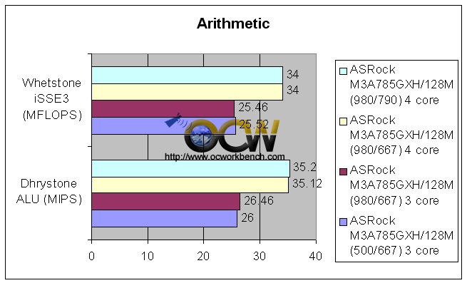

Arithmetic Processor test
With 4 core enabled, the increase in performance is noticeable. In Whetstone, the difference is 33% while Dhrystone gives a difference of 36%. As this is more of a test of the processor, the differences between a DDR3 vs a DDR2 board is very minute. The scores are almost identical.

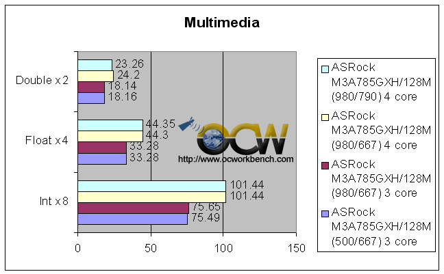

Multimedia Processor test
The improvement in Multimedia test is quite noticeable too. In Int X4 test, the difference is 33% while in Float x8, the difference is 34%. When compared to a DDR3 AMD 785G board, the results didn't differ too much too.
