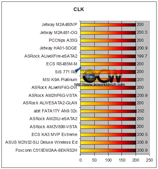

The Jetway M2A480VP run on the dot of 200.00MHz. This is slightly lower than the M2A481-OG board we tested before. Will that impact its results ? We will see if both boards will run simliarly since they're both based on the same chipset.

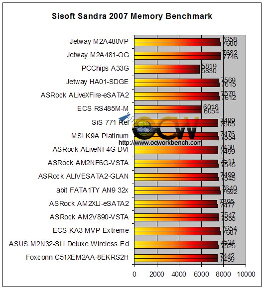

Using Sandra 2007, the memory benchmarks are recorded, they are 7658/7680. This is slightly lower than the M2A481-OG but higher than the rest of the boards.
