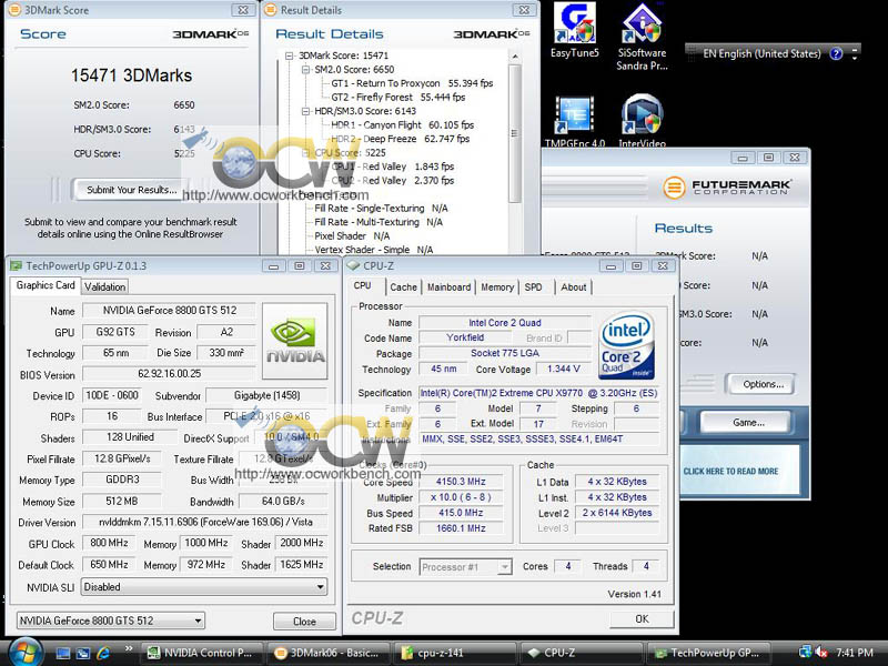

In our overclocking test, we used nTune and managed to squeeze it up to 810/1000. Although we can run it at 830/1010, it is rather unstable. It is all done with the fan speed set to maximum speed.
