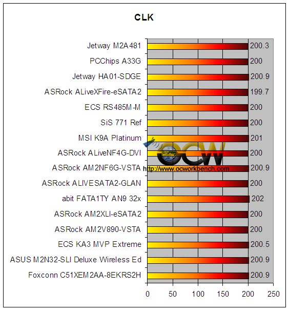

The Jetway M2A481 runs at 200.3 MHz. That is quite an average clk but I would have preferred every board tested to be running on the dot at 200.00MHz. Anyway, the results will be comparable to those running at 200.00. Running a board beyond 201MHz will be considered as overclocked.

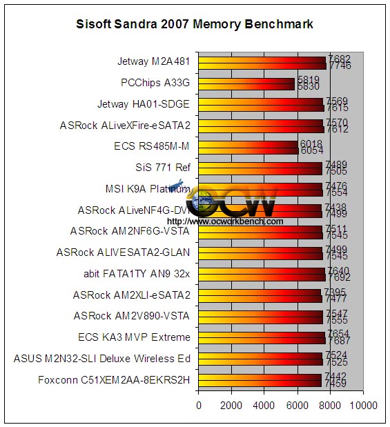

Using Sandra 2007, the memory benchmarks are recorded, they are 7682/7746. That is pretty high I would say if i were to compare it with other AMD 480X (RD480) and AMD 580X (RD580) boards we have tested before.
