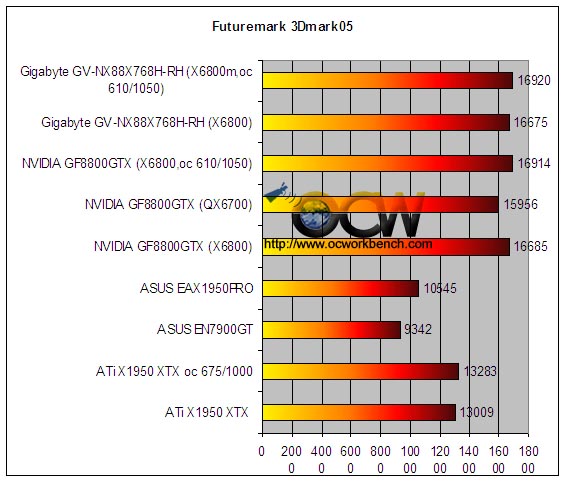

3DMark05
In this test, we ran the card in default clk settings at 575/900 and at o/c speed of 610/1050 using systool. As we can see from the score, the 8800GTX has overtaken the ATi X1950XTX by a whopping 3000 marks in this test. This is really an amazing score.
As you can see from the chart, 3Dmark05 scores better with the X6800 as it has a higher clock speed in comparison when it is paired up with QX6700 (quad core at 2.66MHz). The card can be overclock to 610/1050. Anything higher results in tearing and blue screen popping out.
From the scores, we can see that the 8800GTX is ~28% faster than the ATi X1950 XTX.
As the card is based on a reference design, the scores are very similar to the engineering sample we reviewed before. The small difference in  results falls within the error margin.

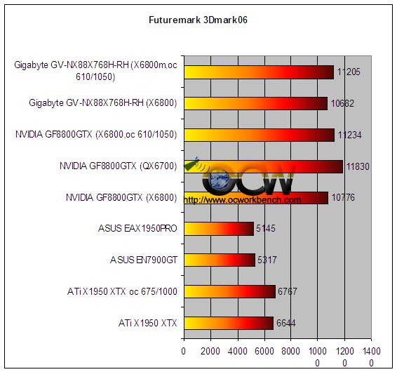

3DMark06
In 3DMark06, the score are very apparent too. The default stock speed sets the record of 10682 while overclocking it gives a 11205 marks.
  SM2 HDR/SM3 CPU Score Total
X6800 with ref 4832 4948 2579 10776
X6800 oc with ref 5096 5761 2568 11234
QX6700 with ref 4812 4935 4064 11830
X6800 with Gigabyte 4821 4902 2535 10682
From the results, we can see that it has surpassed the ATi X1950XTX by almost 62% in this test. That is really an impressive score.
