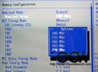

For overclocking, it is better to set the memclk to run in
ASync mode. Notice the 183MHz option. In this menu, you can also set the CAS
Latency, tras, tcp, trcd, async read reamble, latency etc. |

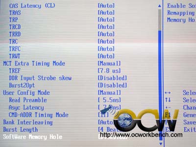

The above are the 2nd portion of the screen showing the other options like
CMD rate 1T, Burst Length. |

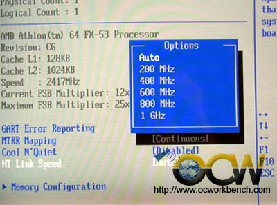

In the HT configuration, Hypertransport can be set to 1GHz. For
overclockers, HT link speed should be lowered so that during overclocking,
the Hypertransport maintains within 1GHz. |

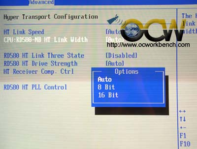

The HT width can be set for 8bit or 16bit. |

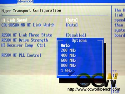

Looks like there is another option here
which can set the HT Link Speed. |
