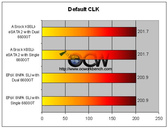

In this test, we measured the CLK used by the boards. The K8SLI-eSATA2 is running at a higher clk of 201.7 and EPOX 8NPA SLI is running at 200.9MHz. As the PCIe bus is locked, the 3D benchmarks would not have much difference. A high CLK will result in a higher CPU test score in benchmarks like pcmark.

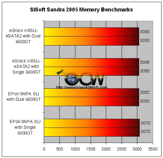

The following are the memory benchmarks of the two boards in two different configurations. They're taken at CAS 2, 5-2-2, 1T cmd. All the boards seem to score almost the same. Note the scores are halved of that of dual channel design.
