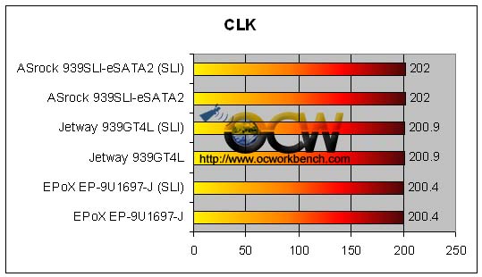

In this test, we measured the CLK used by the boards. The Jetway NF4 SLI board runs at a slightly tuned up clk speed of 200.9MHz. The EPoX EP-9U1697-J runs at 200.4MHz and the ASrock 939SLI-eSATA2 is slightly higher at 202MHz.
As this board supports compatible SLI, we configured it to work in SLI mode with Forceware 81.98 with no problems at all. We added a fan on top of the heatsink to improve stability at 1T cmd. Peg link is set to normal mode.

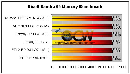

The following are the memory benchmarks of the two boards in two different configurations. They're taken at CAS 2, 5-2-2, 1T cmd. All the boards seem to score almost the same.
