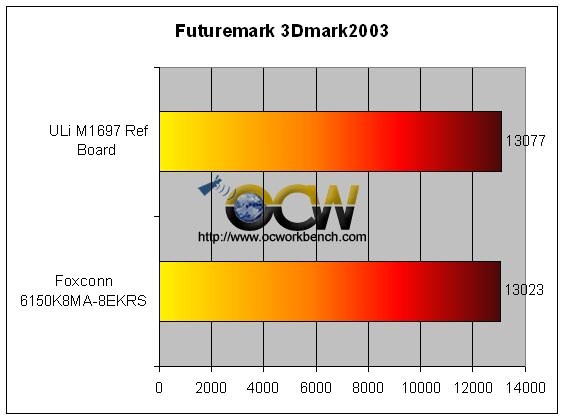

In 3DMark2003, the benchmarks between the two boards are taken. We found that the ULi M1697 board seems to perform better with the ATi X850XT card than paired up with a NVidia card. Below are the scores running the two boards with a Powercolor X850XT PE card. Again,

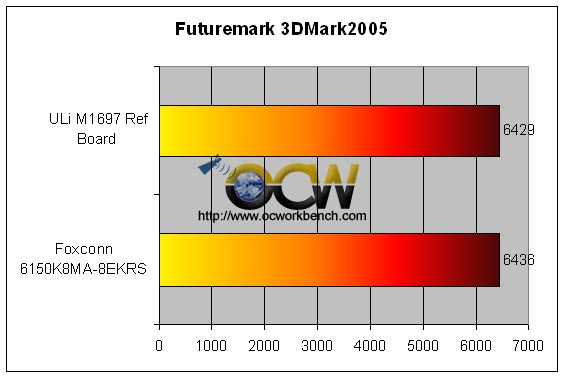

In 3Dmark2005, we get 6429 vs 6436. It seems that the Foxconn is doing slightly better. Could this be due to the 0.2 MHz difference. Well it does have some impact. Since the difference is within 10 points, it is hardly noticable by gamers.
