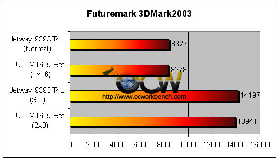

With 3Dmark2003, we test run the boards using 2 pixelview 6600GT cards under 1x16 and 2x8 modes. We can see that the difference between the two in 1x16 mode is 0.6%. In 2x8 mode, the scores do not differ by a lot either. The scores are 14197 versus 13941. A simple calculation will tell you that it is within 1.8%.

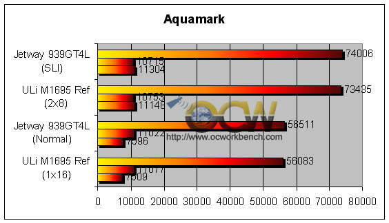

In Aquamark, we check out the scores in 2x8 mode. We get 74006 (Jetway) versus 73435 (ULi). A 0.77% difference is registered. So what about in 1x16 mode? 56511 versus 56083. The difference is also 0.77%.

From the results, it can be seen that the difference between the two chipset's performance in 1x16 and 2x8 does not differ by a lot. In fact, I would say that the results are very good at this initial stage. By design, the riser card could have introduced noise and errors into the system. The longer traces could introduce more latency into the system too. Well, I am surprised by the results too. I feel that if mainboard manufacturers were to adopt a dual slot design, the performance should be on par if not better.
