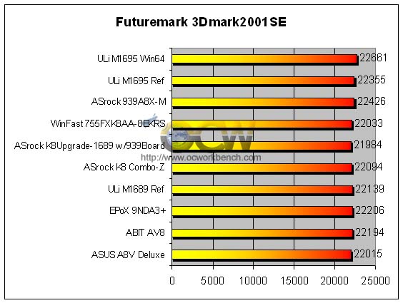

Benchmarks - 3Dmark2001SE/3DMark2003
In this category, we tested the DX8 benchmark. It is apparent that running the board under Win64 with Catalyst 5.5 gives a slightly higher result. With Catalyst 4.6 on WinXP (32bits), the Reference board scored 22355 which again beats even the NF3 and VIA K8T800Pro boards out there.

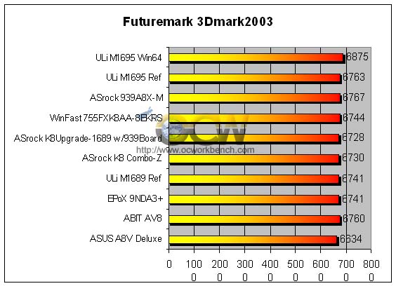

In 3Dmark2003, the board obtained a high of 6875 (Win64) and 6763 (Win32). Again we see that this board has comparable result to the 939A8X-M based on ULi M1689 chipset. Most importantly, this south bridge native AGP implementation is pretty fast. It has again overtaken the NF3 and VIA K8T800Pro boards tested.
