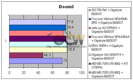

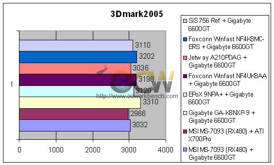

Benchmarks - 3Dmark2005 / DOOM3
In 3Dmark2005, the SiS 756 Reference board scored 3110 which ranks itself 4th among the boards tested. The ATi RX480 boards are no match for it. It is very ironic, for the boards we tested so far, the ATi runs at 199, SiS at 200, NVidia at 201 MHz.
In DOOM 3, the test is done at 1024x768x32 Best quality. The SiS ref board scored 77.8 which is 1 to 2 fps lower compared to the NF4 boards but beats the ATI RX480 board. Will the SiS 756 perform better if it is clocked at 201MHz just like the NF4. I think it is possible.
