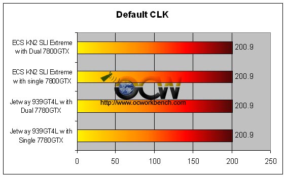

In this comparison, we compare the ECS KN2 SLI Extreme board with the Jetway 939GT4L NF4 SLI board in both configurations : single card and dual card (SLI mode). We made a check of the default CLK running on both boards and they are running at 200.9MHz.

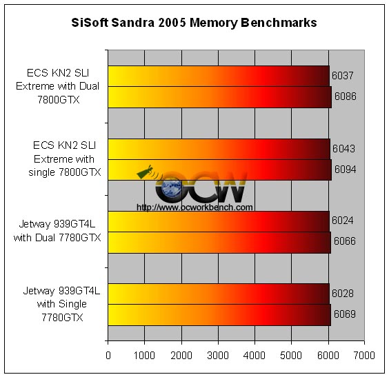

The following readings are obtained using CPU-Z.
The Memory Benchmarks basically gives us an indication on how much bandwidth is there for the I/O. The higher the numbers, the better it is. This is especially true for graphics intensive applications.
