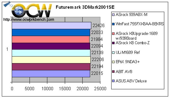

Benchmarks - 3Dmark2001SE/3DMark2003
In this category, we tested the DX8 benchmark.Considering that the budget board runs at 200.00MHz, 22426 marks puts the rest of the boards to shame.
In 3Dmark2003, the board obtained a high of 6767. Again it beats the rest of the boards. Looks like the ULi M1689 is not that slow after all. In fact, this board is faster than the reference board we reviewed sometime ago.
