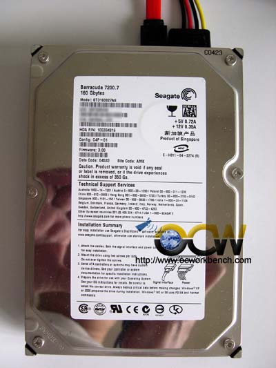

Seagate Barracuda 7200.7 ST3160827A 160G
ST3160827AS
ST3160023AS
 Capacity and Interface
Formatted Gbytes (512 bytes/sector) 160
Interface Serial ATA
 Performance
Internal Transfer Rate (Mbits/sec) 683
Max. External Transfer Rate (Mbytes/sec) 150
Avg. Sustained Transfer Rate (Mbytes/sec) >58
Average Seek (msec) 8.5
Average Latency (msec) 4.16
Multisegmented Cache 8196
Spindle Speed (RPM) 7200
 Configuration/Organization
Discs/Heads 2/4
Bytes per Sector 512
Logical CHS 16383/16/63
Recording Method 16/17 EPRML
Contact Start-Stops 50000
SeaShield System No
 Reliability/Data Integrity
S.M.A.R.T. capable Yes
Nonrecoverable Read Errors per Bits Read 1 per 1014
Service Life/Limited Warranty (years) 5/5
 Power Requirements
+12 VDC +/-10% (amps typ operating) 2.8
+5 VDC +/-5% (amps typ operating)
Power Management (watts)
      Seek 12.5
      Read/Write 12
      Idle 9.3
      Standby 1
 Environmental
Operating Temperature (°C) 0 to 60
Nonoperating Temperature (°C) 70 to -40
Operating Shock (Gs) @ 2 msec 63
Non Operating Shock (Gs) @ 2 msec 350
Acoustics,Idle (Bels-typ sound power) 2.5
 Physical
Height (mm) 26.035
Width (mm) 101.6 >
Depth (mm) 146.99
Weight (kg) 0.635

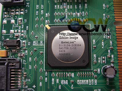

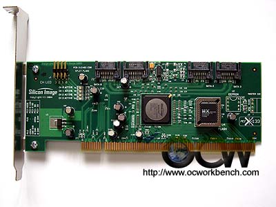

SiliconImage Sil 3124 Host Controller
The Silicon Image SiI3124 is a four-port PCI-X to Serial ATA controller.  The SiI3124 is designed to provide multiple port serial ATA connectivity with minimal host overhead and host to device latency.  The SiI3124 supports a 64-bit 133 MHz PCI-X bus and the Serial ATA Generation 1 transfer rate of 1.5 Gb/s (150 MB/s).
The card is compatible with PCI slot as well.
