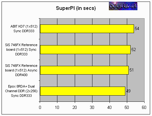

SuperPI
SuperPI is a good test of system stability and also the arithmetic power of the system. The shorter the time taken, the better the performance.
All boards running in SYNC DDR333 (166/166) otherwise specified. The FSB of the various boards are :
SiS 746FX Ref board : 168.2Mhz
EPoX 8RDA+ : 167.05Mhz
ABIT KD7 : 166.88Mhz
Very apparent, the SiS 746FX when run in Async mode, it slashes the timing by another 1 sec but loses to Epox 8RDA+ running in Dual Channel DDR333 mode by 2 seconds.
