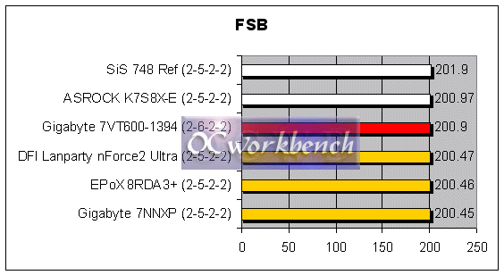

Before we benchmark, we document the FSB the board is running at. The SiS 748 reference board is a bit on the high side. Do bear that in mind when comparing results of the boards as a higher FSB usually will impact the benchmarks in one way or another. ASrock K7S8X-E is registered at 200.97MHz and the EPoX 8RDA3+ is at 200.46 MHz. Gigabyte 7NNXP runs at 200.45MHz and DFI is at 200.47. Gigabyte 7VT600-1394 is at 200.9Mhz.

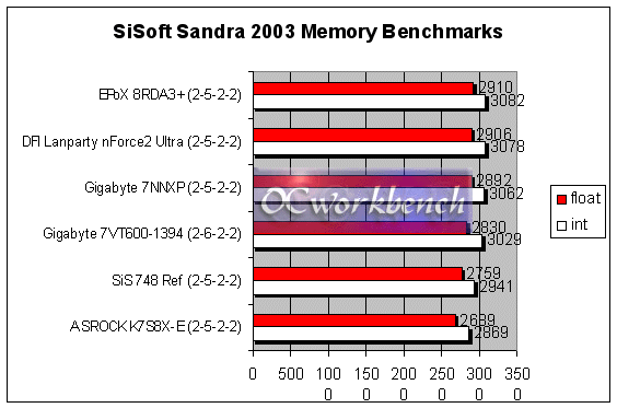

In the comparison, the Gigabyte 7VT600-1394 runs CAS 2, 6-2-2, ASRock K7S8X-E and SiS 748 Reference board is running 1 x 512M Corsair XMS3500C2 Stick at CAS 2, 5-2-2 while the EPoX 8RDA3+ is running 2 x 256M Corsair TWINX512-2700LLPT at CAS 2, 5-2-2. Looking at the benchmarks, it can be seen that Dual Channel DDR400 does have a better memory bandwidth over the single channel DDR 400.
There is no doubt the nForce2 are getting better scores in this category. If you look further down, you would have noticed that the single channel DDR400 boards aren't that far off. It is also important to bear in mind that, a higher score in memory bandwidth doesn't really affect processing speed except those applications that needs lots of memory bandwidth.
