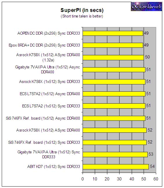

FPU test (fsb:166, AXP2700+)
SuperPI
SuperPI is a good test of system stability and also the arithmetic power of the system. The shorter the time taken, the better the performance.

nForce2 boards still leads with 1 ~ 4 sec faster than other chipsets. In SUPERPI, we see that the K7S8X based on the SiS 746FX is slightly faster than the Gigabyte 7VAXP-A Ultra. In Sync DDR333 mode, the performance level of the 7VAXP-A can't catch up with the nForce2 and SiS 746/746FX.
