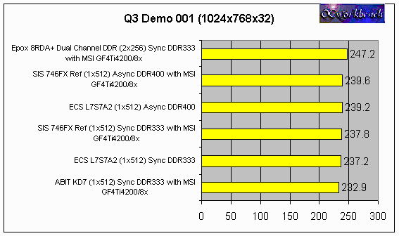

Quake 3 Demo 001
Quake3 demo001 is a memory intensive application and we can see from the chart that the single channel chipsets all lost to the nForce2 by almost 3%. The L7S7A2 lost to the SiS 746FX ref board marginally.

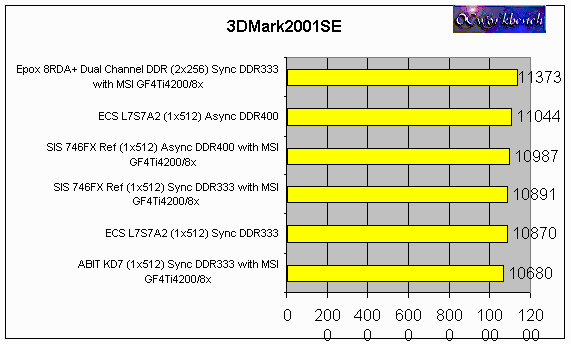

3Dmark2001 SE Build 330
The same applies to the 3Dmark2001SE too with a high score of 11373. A difference of 3% differnece is recorded comparing the ECS L7S7A2 running in Async DDR400 and the EPoX 8RDA+ running in Sync DDR333.

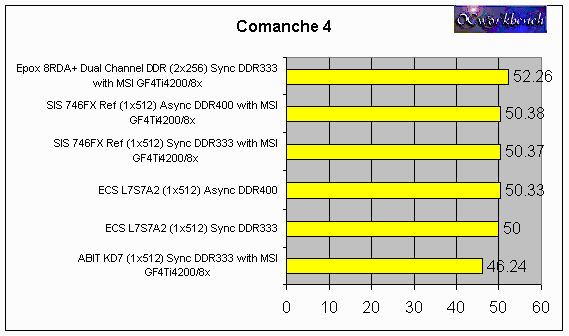

Comanche 4 Demo
In Comanche 4, we see the similar pattern. Epox 8RDA+ scoring 52.26 compared to 50.33 of the L7S7A2.
