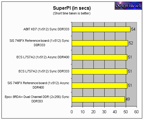

FPU test (fsb:166, AXP2700+)
SuperPI
SuperPI is a good test of system stability and also the arithmetic power of the system. The shorter the time taken, the better the performance.
All boards running in SYNC DDR333 (166/166) otherwise specified. The FSB of the various boards are :
ECS L7S7A2 : 166.65Mhz
SiS 746FX Ref board : 168.2Mhz
EPoX 8RDA+ : 167.05Mhz
ABIT KD7 : 166.88Mhz
It is apparent that the ECS L7S7A2 is pretty good as it scores 51s at 166/166 compared to the SiS 746FX ref board. Epox 8RDA+ completes the test in 49s.
