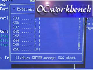

The FSB can be set from 100 ~ 233 and at
random intervals shown above to 250Mhz |

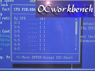

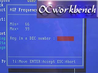

According to nvidia,
nforce2 has PCI fixed at 33Mhz. AGP can be set from 66 to 99Mhz |
![](Picture%20952%20copy.jpg) |
![](Picture%20953%20copy.jpg) |
Async settings are not advised on nForce2 as
the performance drops drastically. It is best to run it in Sync mode. |

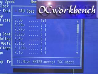

CPU Vcore can be set up to
2.3v at the intervals shown above. |

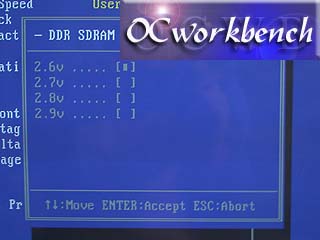

DDR Voltage can be set as above max at
2.9v |

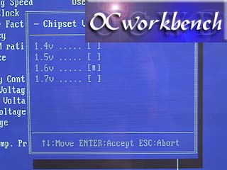

Chipset voltage up to 1.7v |

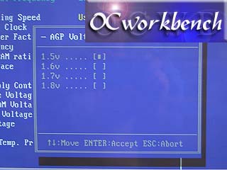

AGP Voltage can be set up to 1.8v |

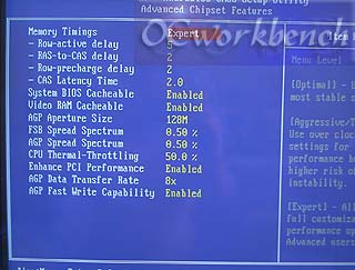

In our test, we can set it to 5-2-2, CAS
2 using an AXP 2700+ |
