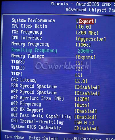

We first tested at 217Mhz x 8 at CAS 2, 4-4-8. The system POSTED but it was extremely unstable resulting with a blue screen during benchmarking. We tried lowering the multiplier to 7x but the same problem persists even if we raised the voltage to the max Vcore of 1.9v from the BIOS.
Next, we reduced to CAS 2, 2-2-5, 9x210Mhz seems OK but very soon the system gave way and screens becomes garbled. We reduce T(RAS) to 6 (previously was 5). Same problems. We reduce it further to CAS 2, 6-3-3 and see what happens. The system is again unstable. Below are the various settings we tried. We ended up having a stable system that is able to run through all the benchmarks at 200Mhz x10(CAS 2, 2-2-5) : Stable

We tested again using the Epox 8RDA+ with async ram timings set to 150%. We set the FSB to 145Mhz and RAM is running at 217Mhz (DDR434). Surprisingly we are able to push it all the way to 220Mhz (DDR440) without any problems. The ram timings used were CAS 2, 2-2-5 at the same voltages.
We ran a series of tests using Quake3 Demo001, Comanche 4 Demo, 3Dmark2001SE, SuperPI, SISoft Memory Benchmarks. Everything seems fine. We have attached some of these results here when we run it at 10x200 at CAS 2,2-2-5.

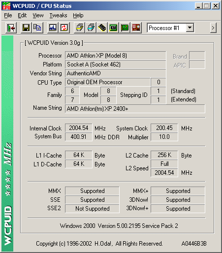

WCPUID (133x15) 133.64
WCPUD (200x10) 200.45

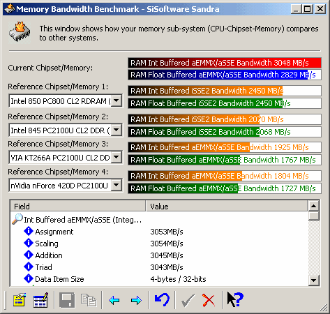

SISoft Sandra Memory Benchmarks   ALU    FPU
AXP 2400+ (133x15) 2031 1924
Overclocked (200x10) 3048 2829

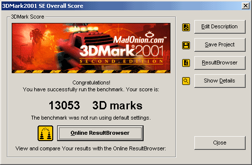

3Dmark2001SE
AXP 2400+ (133x15) 11933
Overclocked (200x10) 13000
