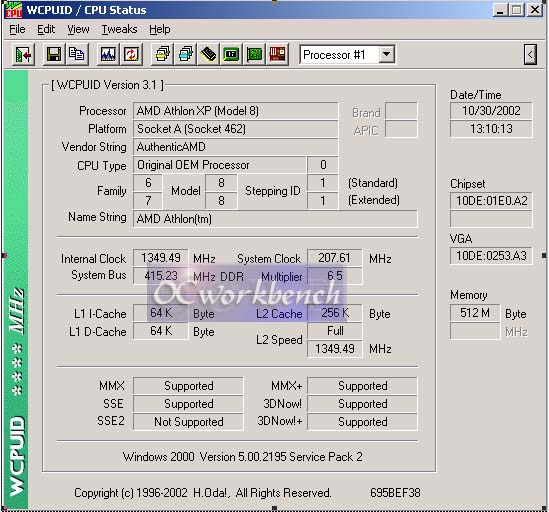

We went ahead and chose the lowest multiplier 6.5x and FSB of 200Mhz. Yes it POST, SuperPI ran well at the same score of 1min6secs. Next we increase the FSB to the other available selections 204, 207, 211, at CAS 2,2-3-5, everything seems ok and they include SuperPI, Quake3, SIsoft Sandra. They went through but the system doesn't seem too stable.
We decided to lower the FSB to the next highest which is 207Mhz FSB x 6.5 = 1340XP

* overclocking a system voids warranty. To maximise FSB by lowering the multiplier, you would probably end up with similar scores except for a better reading on Sisoft Sandra Memory Benchmarks. Stability is also compromised. In our tests, we assure maximum overclockability by lowering the multiplier and use aggressive ram timings for max FSB. It might be possible to attain stability at 211Mhz if you would lower the ram timings to CAS 3. 4-4-8 or so. Unless you o/c without changing multiplier, this Tbred can reach 145Mhz easily.
