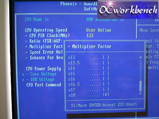

ABIT AT7 Max2 provides a large range of multipliers so you do not need to worry about the problem of compatibility with future CPUs with higher multiplier of up to 18x.

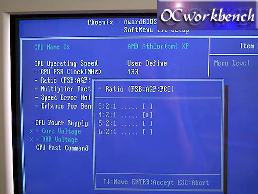

ABIT SoftMenuIII allows quite flexible combinations of Ratios too. 3:2:1, 4:2:1, 5:2:1, 6:2:1. Looks like you would be running 33/66 (PCI/AGP) when your FSB is 200Mhz

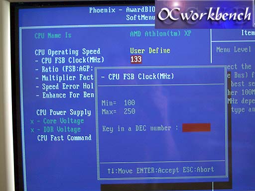

FSB range : 100 ~ 250 at 1mhz stepping

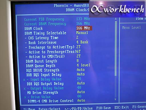

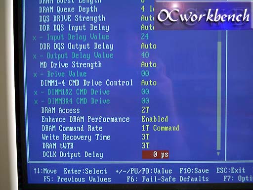

In our test setup, we ran the system at the following timings below. CAS 2, 2-6-2 (Active to precharge does not have a setting for 5). Burst Length 8,
DRAM Command Rate 1T cmd, DRAM Performance is set to Enhanced. RAM Module used is 1 x 512M Corsair XMS 3200.
